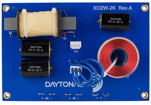

Whether you buy a “pre-made” crossover for your speaker or custom build your own depends on your objectives, experience, and your budget. In many applications, pre-made crossovers can provide essential filtering functions: distributing the correct frequencies to the appropriate speaker components. If selected properly, these convenient crossover networks deliver the proper protection and satisfying sound quality. Parts Express carries many pre-assembled crossovers in a variety of configurations, crossovers, and use applications.
Audio enthusiasts in search of higher fidelity reproduction can choose to invest in the time and labor to design, assemble, and test their own high-performance crossover networks. Advanced design/test/measurement tools are now available to hobbyists; there are inexpensive solutions that just a few years ago were the exclusive domain of professional designers and engineers.  Whether your goal is to enhance your speaker hobby, or you simply wish to restore the functionality of an old pair of walnut-veneered 3-ways from the 70s, Parts Express is your resource for the knowledge and components to achieve these goals. If you need help finding crossover components, we have a Crossover Guide that helps make your search for the perfect components easier.
